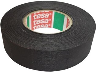

  • with trendy finish: ...fabric tape on the bottom edge of the screen, so that the image at the bottom doesn't accidentally blend perfectly with the ambilight
  • and additionally ULTRA immersive Dolby Shitmos
OLED909
Tape ;) = bottom finish

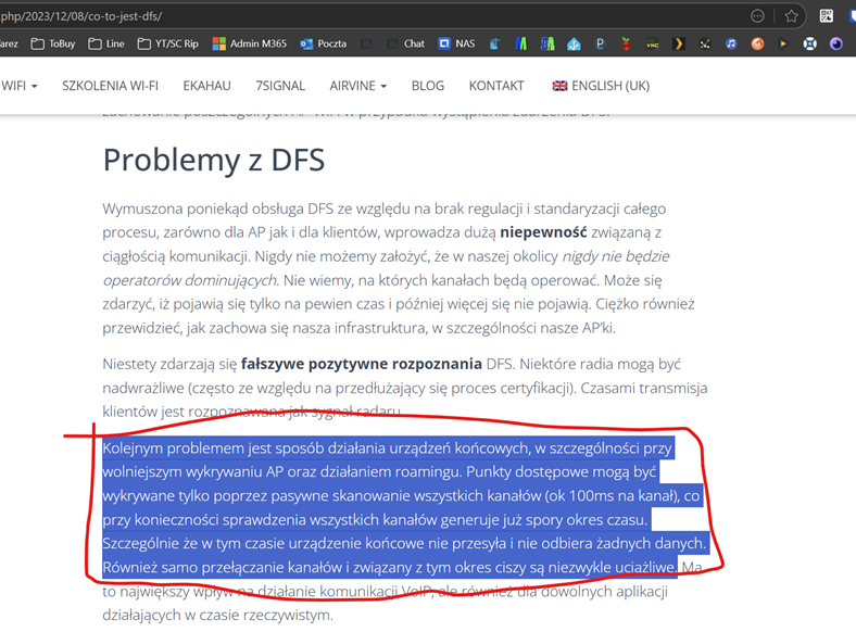

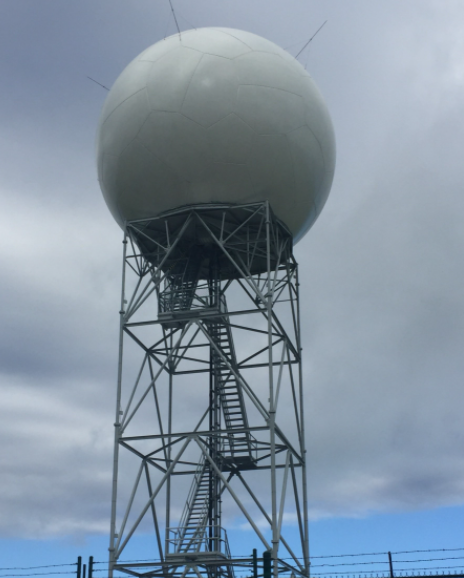

Scenario 2: near DFS radars, WiFi can disappear for 2-3 minutes.
more info www.audyt-wifi.pl/.../co-to-jest-dfs

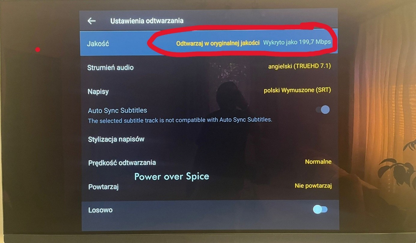

The LAN parameters are equal to a network card from 25 years ago. Premium class TV for 13000 PLN with a vintage network card with 100Mbps throughput. How am I supposed to play a BluRay UHD REMUX that needs 200Mbps peak throughput on a 100Mbps LAN?

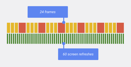

The refresh rate is always at 60 or 120Hz (games) and doesn't allow movie playback applications to change the refresh rate to match the frame rate of the video material being played.
24 fps cannot be perfectly displayed at 60hz – some frames will always be skipped or there will be more of some – which means that a movie played from Android level on the TV is not displayed correctly! The problem basically only affects Philips TVs. Samsung doesn't have this problem! You can take any Chromecast Stick, Amazon Stick, Xiaomi TV, connect via HDMI, install an application allowing refresh rate changes – and it works. On Philips – it doesn't work.
